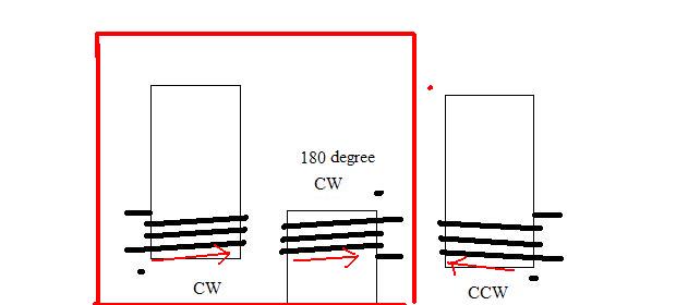

    Additional note
    If you start to wind a coil in CW mode then if you turn it 180 degree it will still be a CW winding you cannot change the winding direction buy rotating it!
    http://www.energeticforum.com/attach...1&d=1339272316
    take care about that
    Zilano what do you think are these equations right! Or should I change something? Although 13000V for me is too high.
    rgds blackrobi

          Additional note
          rgds blackrobi
          U MUST CHANGE THE LENGHT OF PRIMARY MAKE IT SHORT. and recalculate. when resonance happens then voltages work according to Don smith calculation.
          yes u r right about coil it was a mistake on my part. turning 180 degree wont make it cw or ccw. sorry about that. but when working with dc polarity instead of ac polarity things are different ns poles becomes Sn. u will get the hang of it. when u will experiment.
