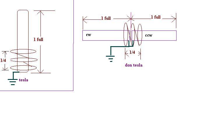

- Seems that you connected the bulb in parallel to the capacitor. What happens if you connect it to the other secondary coil (now open)?
- Conforming Utkin (see Patrick's online book) the cap performs the required short circuit at the operating frequency. Not shure if he is right. Maybe this coil/cap will run best in resonance mode. Conforming my initial measurements the cw/ccw behaves very unexpected and strange. On the other hand we expect it to not obey standard scinece
