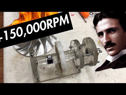

After reading all of Tesla's final rotor design patent.
We can use a single disc with no holes.
Tesla writes that if you use an even number lets say 15 discs. The centre disc doesn't need exhaust holes.
The other 14 discs would need exhaust holes.
If the rotor has 10 discs then they would all need holes....
Makes for good balance.
I'll post the CAD files soon.
Some off the shelf components for my 150mm 3D printed or milled design.

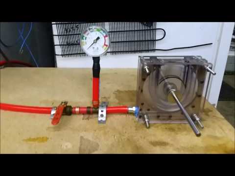

After a little direction from me about how to make the turbine case, here we have the next build.
Anyone familiar with exhaust back pressure will have a clue what is going on here.
The turbine appears to now be able to run on atmospheric with no valve. It will self regulate according to the 1,061,206 patent.
With the valve it will need to be controlled with the air tap or it will run away!
https://www.dropbox.com/work/Team%20...201_182238.mp4Last edited by soundiceuk; 01-27-2020, 02:11 PM.
Hello Soundiceuk,
You seem to be saying that if you add the valvular conduits then once the turbine is running the compressed air supply can be removed and the turbine will continue to run and make power.
Is that correct?
I do not see any possibility of this so far. This video shows positive pressure at all times. At 5 psi gauge that is 5 psi above atmospheric pressure or about 19.5 psi absolute. In order for this to self run it would have to have a means of compressing ambient air to 19.5 psia or re-compressing the turbine exhaust to the same. Alternatively it would need to have a means of maintaining a 5 psig pressure drop at the turbine exhaust.
Would you care to elaborate on your method for accomplishing either of these?
Cadman

Originally posted by Cadman View PostYou seem to be saying that if you add the valvular conduits then once the turbine is running the compressed air supply can be removed and the turbine will continue to run and make power.
Is that correct?
After initial starting of the turbine, what I see is the device self running and self sustaining with no valve!
Also after initial starting, what I see is with the valve fitted it can run away and implode if left to cascade!
We all need to see this with our own eyes for it to be real, but it appears to me that this is within our grasp according to my research and Tesla's writings, articles, drawings and patents.
The one-way valve is just that. A one-way valve. It will do nothing to cause the turbine to run away. And although the turbine is a marvelous invention of Tesla it will not run off atmospheric pressure. It has been used now by industry for many years since they finally discovered how much more efficient it is. It also needs much less maintenance than any other turbine because it can stand some wet steam which will destroy a regular turbine. But there have never been any reports of one of them running away. They also make excellent pumps for pumping all kinds of liquids. I understand the oil industry uses a lot of them as pumps.
