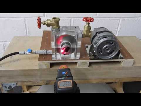

        • This "cold steam engine" presentation was made by an ex army nuclear physicist to help people understand the theory.
          I've currently got this 1921 Mk2 Tesla Vacuum Pump casing being 5 axis machined in clear acrylic.

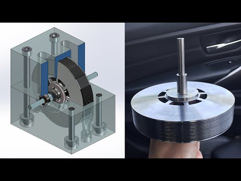

          Here is the Mk2 design. The new design is longer and prevents axial as well as radial play. The taper of the Mk2 rotor takes care of the axial play but the new air bearing design physically prevents it too which will ensure the rotor can never contact the casing. The rotor has an odd number of discs and a solid centre disc to create twin vortex paths. This is to eliminate side thrust.
          Electrically this would be like having a centre tap.

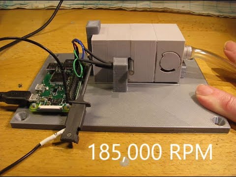

          • The world record has been broken for the fastest accelerating single stage Tesla turbine by Rob Meades using my Tesla Cube 3D printed design.
            I advised him to use GRW bearings instead of the SKF bearings I used.
            He is now working on a way of measuring the RPM using an AC motor and Hz meter.
            For the complete build guide so far check out:
            http://www.meades.org/misc/all_thing...gs_nikola.html
