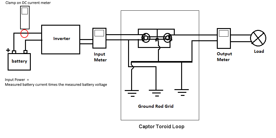

                  • Originally posted by wantomake View Post
                    Level,
                    Thanks that's good advice and is all my abilities and time will allow me to do. I'm thinking to place a circuit analog meter on the battery to have something to read each test. I want be able to help others to build here as we progress. Plus start recording readings as I add each rod. Don't know if makes any difference, but I live in very high geomagnetic area here. I appreciate any advice.
                    Hello wantomake.
                    Yes, you can put an anlaog current meter in one of the battery wires, but the current from the battery could potentially be quite high, such as 30 Amps or even a lot higher depending on the particular load you are powering. If the current is a lot higher than what your analog meter is designed for, you could possibly damage the analog meter, so just be aware of that. This is one reason why people often use clamp on current meters when measuring high currents. They are usually designed to be able to measure high currents without any issue. I have attached a drawing that shows how it would be done with a clamp on DC current meter. You can measure the battery current either on the battery plus or negative wires, it shouldn't matter. Some clamp on meters have a dial that you can change for either AC current or DC current. That would be ideal for this type of setup. Also check to see what the maximum current is that a particular clamp on meter can measure. The rectangle part in the diagram labelled 'Captor Toroid Loop' would be whatever B&L configuration or other circuit setup you are testing with.
