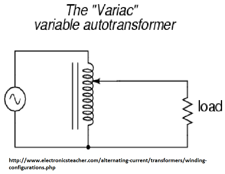

                          It is not your typical variac as those are auto-transformers.
                          Note the non-continuous winding and the common connection (node) input to output.
                          Be it a variac or potentiometer, it will be difficult to make and unlikely to last very long with continuous rotation of the wiper and fairly high RPM. I think you guys would do better using a commercial commutator and brush (including slip rings if needed) which are made for high speed moving contact.

                              Interesting device. I'm curious as to how it would work.
