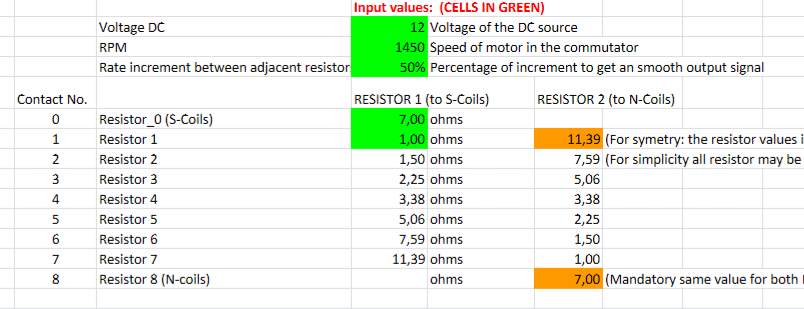

      • Ufo,
        If you are going to test shortly the resistors please take into account that Figuera represented a simplified commutator design to “make easy the understanding” as he literally wrote. I guess he could have used one commutator with two resistors arrays in parallel to get symmetrical signal to each set of coils. If you use just one array then the resistance in one side depends on the resistance in the remaining resistors in the other side of the brush contact. Therefore the two waves wont be symmetrical. Using two arrays in parallel you may get independent resistance in each array and therefore we will get symetrical waves. Some posts ago I linked an Excel file simulating one and two resistor arrays.
        I know you love asymmetry but in this case I guess we should look for two symmetrical signals !!
        BTW , 47 ohms in each step of resistors is huge. I will point more toward 4.7 ohm in each piece or even less, as low as 1 ohm, if you use the same value in all resistor pieces. And if you want to create a perfect sine wave I would use two resistors arrays with values as those included in the attached image
        And below the case for just one resistor array, as drawn in the patent. Note that the higher the resistance of each piece the more asymmetrical waves will be obtained. 1 ohm is fine in each piece for a good shape with 12 V DC source and each set of coils with 7 ohms

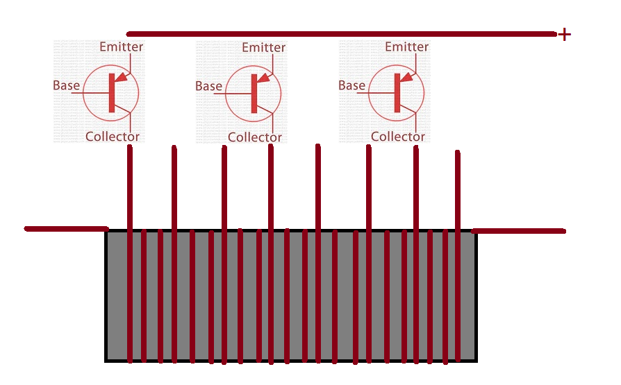

        • Part G
          While i won't stop anyone from building what they want, using resistors at 12 volt might be fine for a test rig, it is absolutely insane for a high power rig that puts out kilowatts of power. you cant put amps through a resistor fellas.
          high power resistors are crazy expensive and get hot so you will have to rethink your idea when building those higher power rigs. to me it would be more practical to build part G that could be used for both.
          below pic is an idea for you guys off the top of my head that would fulfill your needs.
          just a thought.
          MM

              • Originally posted by hanon1492 View Post
                Ufo,
                Hello Hanon,
                Thanks for your concerns.
                I understand what you are saying perfectly well.
                What am doing is just a test rig with what I have available...I do have lower values resistors, but not of high wattage.
                If resistance is too high I will increase Voltage...until I obtain a Bulb lit at both ends. It is Sunday, so can not just go and get new resistors.
                As I also look at your resistors chart with so many variable values...looks like a real nightmare friend!!
                I know Figuera's drawing is very simple not only for better understanding, but to put it in the best "general terms" as possible.
                I now understand why Marathonman chooses his VERY SIMPLE Core approach wound with Nichrome wire, making a "custom" round rheostat...where the wire windings will actually provide MUCH smoother signal than fixed resistance values...You see, at very high RPM's...these fixed values will never survive keeping an exact "ohms count"...it is based on real experimenting friend, not computer simulations...
                [IMG][/IMG]
                And as a matter of fact, when higher speed is reached, your bulbs in your video will "barely" light up their filaments.
                Now, I see you are adding diodes in your diagram...so you must account for each diode resistance right?
                I am really applying what you have mentioned before...the KISS Approach:
                [IMG][/IMG]
                Then see what I get at low and high ends.
                Thanks much for your advice(s), I can see those signals and resistors values graphics have been carefully elaborated.

                  • Ops !
                    Mario;
                    You are very correct, the turns figure i posted is incorrect. let me check again. i know the primaries are right. note book drying out.
                    The thick commutator bars were actually thick wire or more then likely rectangle wire with not many turns.
                    my part G is being wound with thick rectangle wire to take up more space having less winding's. so Netica you are correct in your assumption.
                    below pic is for the people who wish to electronically switch the Figuera device.
