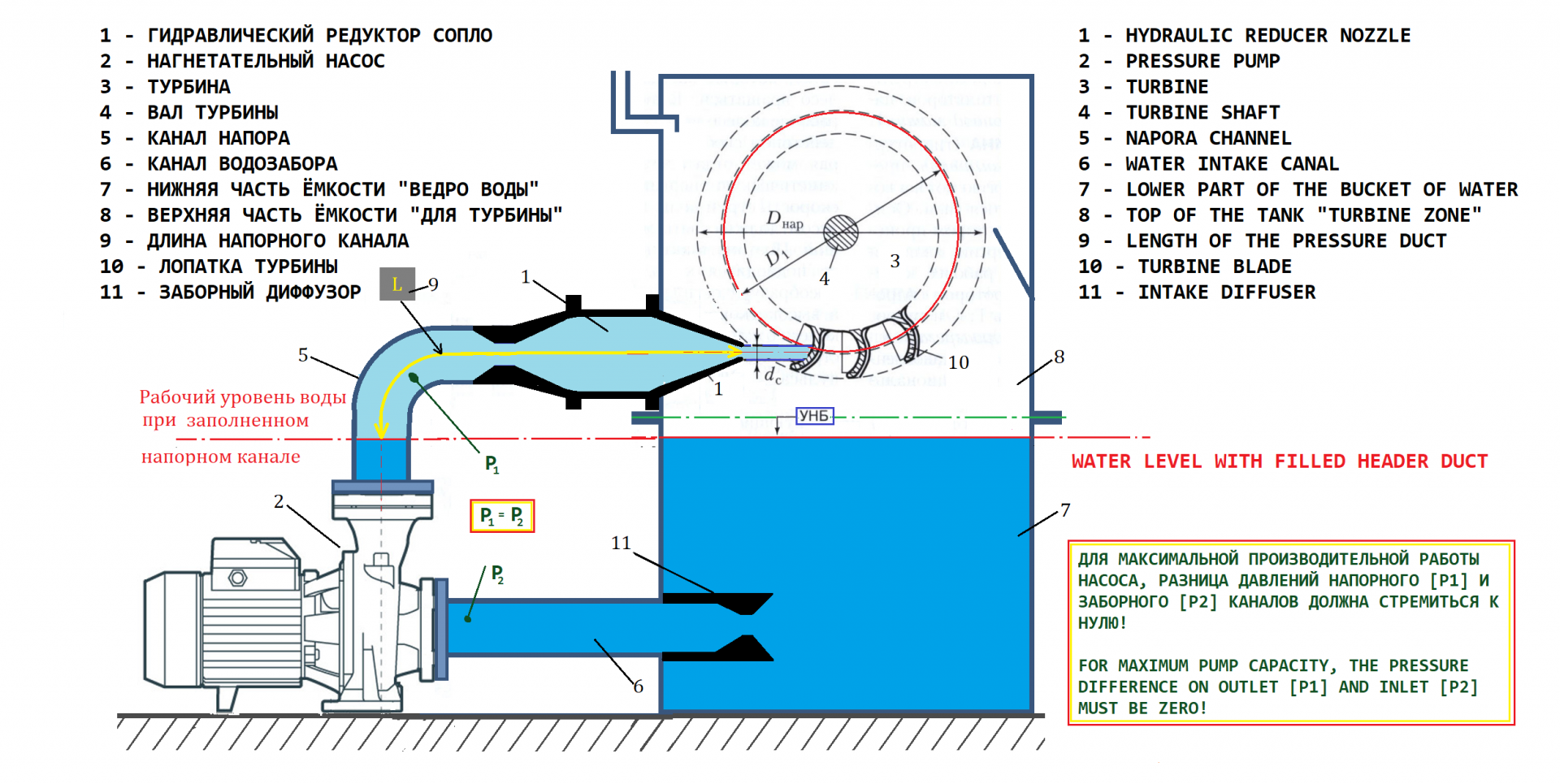

        My book is devoted to the main secret of an autonomous hydrogenerator, which eliminates all the contradictions of the hydraulic circuit and makes it possible even to make it yourself.
        A book in English with a calculator (in an Excel workbook) to calculate the system.
        Everything you can buy. To be done: a tank (in the dimension of a barrel) and a simple hydraulic reducer.
        My humble job, now the bad guys can't stop you from making a free power generator.

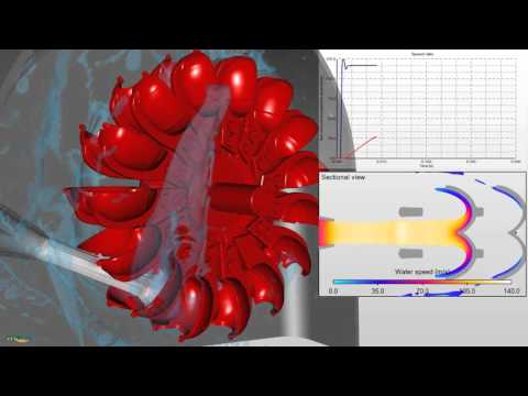

              Made with a paddle water wheel, paddles look like spoons with 2 v splits. Hydropower. I do not understand the principle. Magic? Donno. Tesla patents?
                Pelton Turbine generator

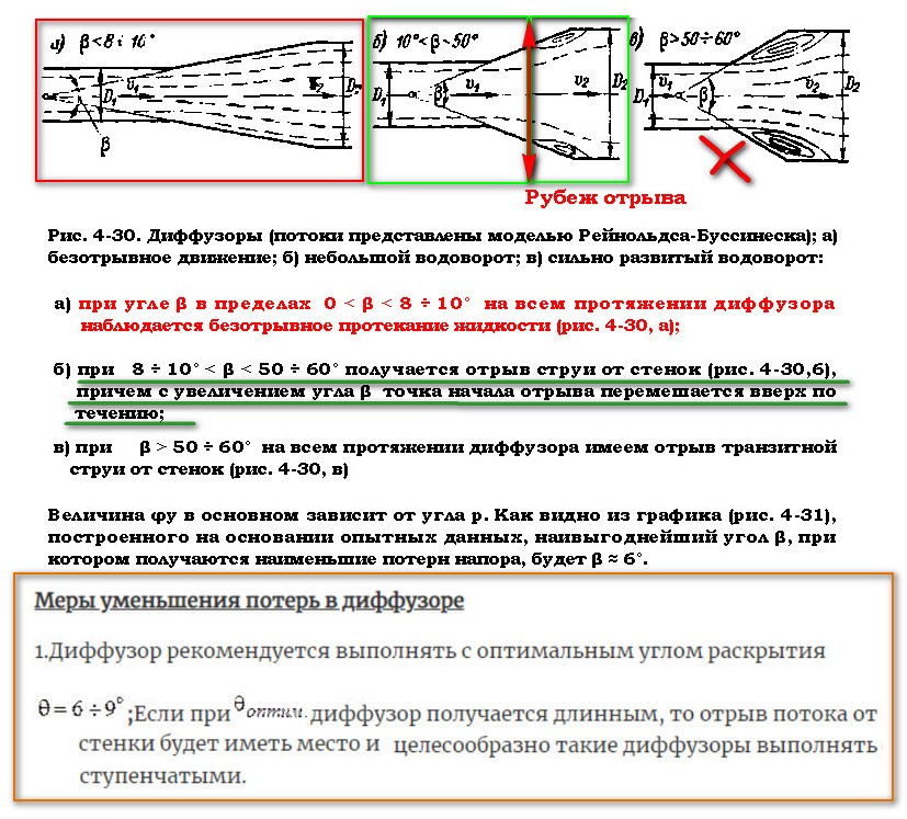

                    and other hydraulic engineers who were impressed by this design identified the expansion diffuser in front of the outlet as the most vulnerable point in the design. Yes, indeed, in a simple calculation, everything is simple and does not contradict the laws of hydraulics. But the coefficient of pressure loss, or rather speed, depends on the cavitation processes. And the most interesting thing is that all this is well studied, there are corresponding solutions.For example, the diameter of the maximum expansion is 182 mm, the diameter of the outlet pipe of the pump is 75 mm, the length of the diffuser cone, with an expansion angle of 6 degrees, will be about 1200 mm. Hydraulics claims that a long diffuser can cause cavitation, which will increase flow resistance. And one more detail - it is technically very difficult and expensive to make such a transition with polishing the inner surface in the mirror. Again, there are solutions for the cascade variant of the diffusion transition.Firstly, we can increase the angle and decrease the length of the diffuser (cavitation at a cone angle of 10-50 g starts from the middle, which means that in the middle (or better, closer to the inlet diameter) there should be a pipe section of the transition section. If at an angle of 40 degrees, the drag coefficient ξ = 0.5, then at 6 degrees = 0.07 (but the possibility of cavitation remains.) I calculated the cascade in four links, received the indicators in each section: (1 section 20 degrees) ξ = 0.046; (2 section 20 degrees) ξ = 0.043; (3 section 25 degrees) ξ = 0.042;(4 section -15 degrees) ξ = 0.041 It turns out that even if the length of this section increases to 1500-1700 mm, the resistance to fluid flow decreases. reality, it will decrease.In the nozzle zone at the corresponding angle, a negative resistance is obtained equal to ξ = - 0.68
                    PS. A hydraulics worker at an oil refinery wrote to me about the cascade implementation of the diffusion transition task. They have such tricks when pumping gasoline into the channel. Later, I found a brief reference to this possibility in academic sources.

                      Serge, I have read in Your booklet and You seem to propose a closed-loop hydro-electric power plant for everyone that is interested in free energy devices to power a home (for example).
                      I would like to ask You therefore - Do YOU already have build a working device that is showing a "COP" (Coefficient of Performance) > 1 ?
                      I am curious because You propose to let a centrifugal pump run with maximum flow rate and minimum pump head produced : (run at the very right-hand corner of the pump-diagram)
                      (a Quote from Your booklet: )
                      "...To ensure the ease of operation of the pump, it is necessary to ensure the differential pressure in the inlet and outlet of the pump, which should tend to zero.
                      (End of Quote)
                      Serge, as far as I know this is when the electrical consumption of the pump-drive-motor becomes maximum and even can destroy the windings in the electrical motor (heat melts the insulation of the wires of the winding in the motor).
                      If I get You completely right, Serge, then You are saying that a clever arrangement of converging and also diverging pipes (nozzles) will not only convert the static pressure energy of a fluid into kinetic energy (at the exit-nozzle) but also the "brownian-molecular movement" of the molecules of the fluid
                      (which is a representation of the heat-energy / temperature contained in the fluid)
                      - can be "organized" into a conform flow-pattern with the help of "DE-LAVAL" Nozzles (for example) and thus You can harvest "a surplus" of energy out of a mass of water that is being pumped around in a closed loop ?!? (and is being directed towards a PELTON style water turbine blade wheel).

                        Unfortunately, the micro-hydroelectric power plant with a converging diffuser transition turned out to be wrong. In a pipe with the outlet water pressure from the pump, a hydraulic accumulator is required with an increase in pressure in front of the nozzle. I left this topic because I have no time to deal with it. At the moment I'm working on an excellent version of the simplest transgenerator in dynamic and static execution. The first to build transgenerators Tesla 1889 (dynamic) and Figuera 1902(static).
                        After almost five years of working out their version of the transformer, it turned out that all this had long been invented. And that's why they don't make it public, I think you know. Free electricity is the enemy of the consumer world-eating market.

                          Hello Serge,
                          Thank You for clarifying that this micro-hydroelectric power plant turned out to be wrong.
                          Also that is a very important information so that interested people do not invest their precious life-time into
                          subjects that ultimately are a dead-end street.
