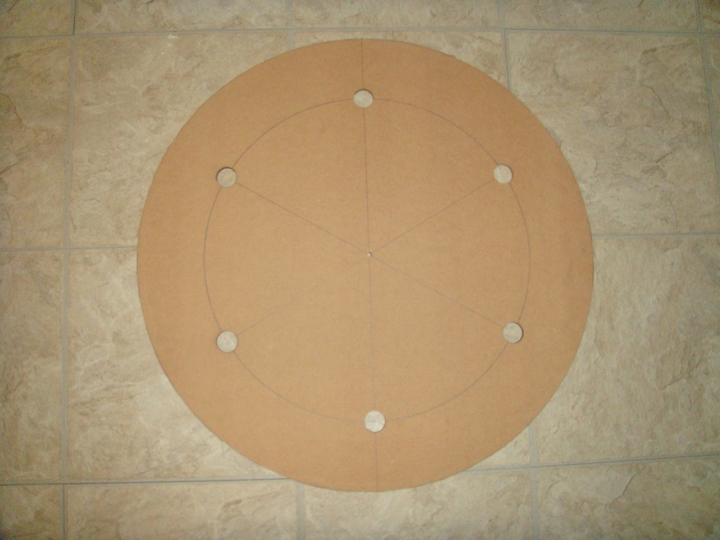

I was able to cut out my larger 24 inch wheels, and to bore the 27 millimeter holes in them. Here's a view of one of the wheels. The holes are centered on a 17 inch circle (8.5 inch radius) at a point where each of six 60 degree radian lines intersect that circle. The hole at the center of the wheel is drilled 1/4 inch to accept a 1/4 inch x 2 inch long stove bolt that is fitted with a 1/4 inch washer on each side of the wheel and then snugged with a 1/4 inch nut. This way I can mount the stove bolt in a drill chuck to rotate the wheel as I sand the rough cut perimeter, which was cut with a saber saw. After sanding the perimeter, I will enlarge the center hole to 3/8 inch to accept the shaft which the wheels will be rotating upon.
